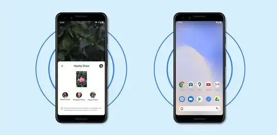

Android phones (like Google Pixel phones and Samsung phones) have a feature called Nearby Share. When sharing an item, you can select "Nearby" or "Nearby Share", and it will allow you to share an item to a nearby Android phone or ChromeOS device.
According to Google's blog post, it uses these technologies:
Nearby Share then automatically chooses the best protocol for fast and easy sharing using Bluetooth, Bluetooth Low Energy, WebRTC or peer-to-peer WiFi — allowing you to share even when you’re fully offline.
Screenshot from blog post
Is there a way to share using "Nearby Share" from an Android phone to an Ubuntu device, or vice-versa?
