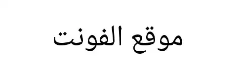

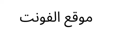

I want Ubuntu 22.10 to display serif Arabic text in the Noto Naskh Arabic typeface while sans-serif Arabic text in the Noto Sans Arabic typeface.
Specimen of Noto Naskh Arabic.
Specimen of Noto Sans Arabic.
