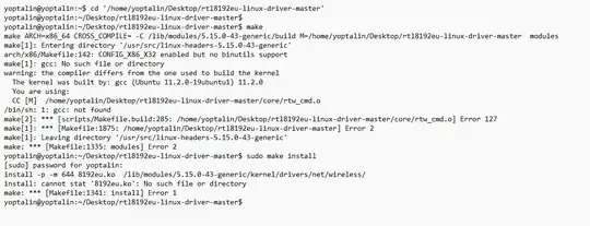

upd: I installed "make" package and tried to install driver but it instead it gave me this:
upd 2: so I did this:
sudo apt install build-essential -y sudo apt install git
and then went on github and paste that:
sudo apt-get install git linux-headers-generic build-essential dkms after that I added driver to dkms: sudo dkms add .
and then tried to install it:
sudo dkms install rtl8192eu/1.0
aaand it gave me this that:
'make' all KVER=5.15.0-43-generic.......(bad exit status: 2) ERROR (dkms apport): binary package for rtl8192eu: 1.0 not found Error! Bad return status for module build on kernel: 5.15.0-43-generic (x86_64) Consult /var/lib/dkms/rtl8192eu/1.0/build/make.log for more information.
