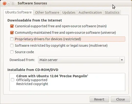

This is most probably what is being referred to (see bottom right):
Is there a way to toggle this option now that it is installed? Thanks.
After installation, here's how you can manually toggle repositories on or off to mimic the "use only free software" option in the boot menu of the Live CD (chosen via F6). This answer does not get into the semantics (meanings) of "free" :)
  • Open Software Center
  • Go to the Edit Menu on top, click Software Sources
    • Turn off the third and fourth options -- (restricted) and (multiverse) to be "Use only free"; turn them on to use them. Note that Ubuntu (at least the text installs) still asks you during the install, even if "Use only free" is not checked, to confirm whether you want to add these to your sources.

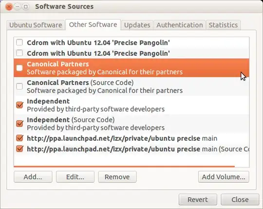

    • Another question also asked is whether you want the "partner" repositories (which may not have source available, so may be non-free). Disable or enable the "Canonical Partners" repositories under "Other Software" as you wish.
