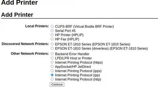

  3. Navigate: Administration -> Add printer

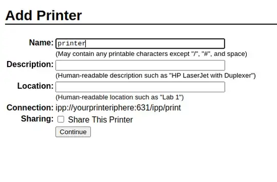

  4. Choose: IPP as protocol enter image description here

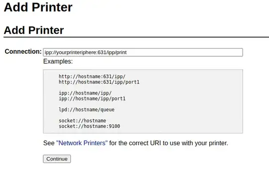

  5. Enter the address like this under connection ipp://yourprinteriphere:631/ipp/print enter image description here
  6. Give the printer a name enter image description here

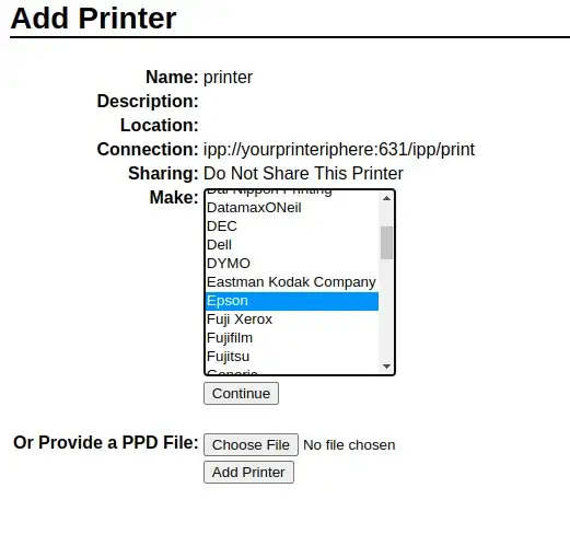

  7. Choose EPSON under Make and press continue enter image description here
  8. Select IPP everywhere and click "Add Printer" enter image description here

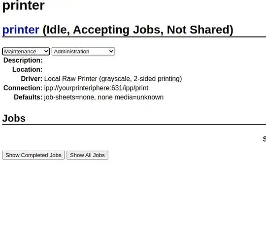

  9. Confirm defaults
  10. Under Maintenance choose the "Print test page" enter image description here
