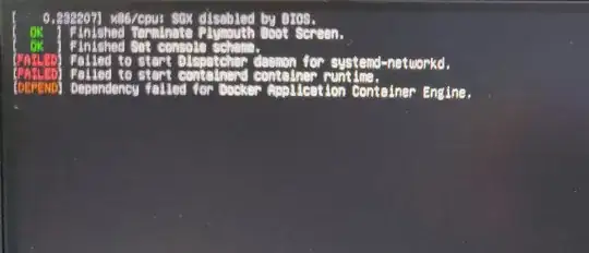

EDIT2: I have attached a screenshot of the boot screen, apparently containerd, docker engine and snapd are failing in the boot screen for whatever reason.
Boot Screen
EDIT3: So after completely removing docker and containerd from my system, the issue still persists.
