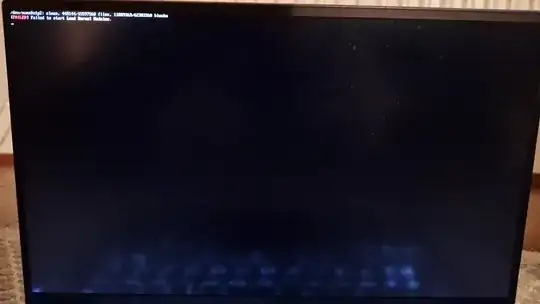

On boot, I see a [FAILED] Failed to start Load Kernel Modules. error message.

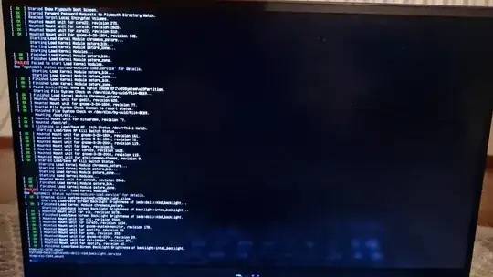

As shown in the below images from my phone, as I am unable to enter the GUI of the OS and take a screenshot, I see: Error Message 1
Error Message 2

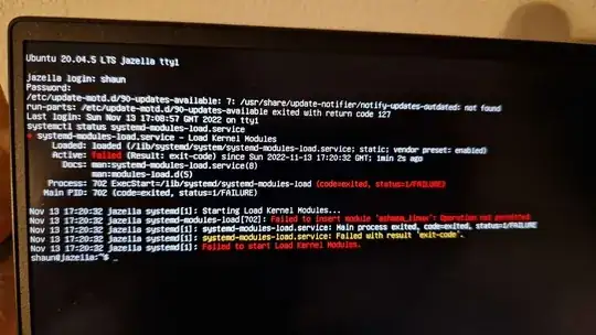

As suggested in the error message, I checked systemctl status systemd-modules-load.service for details. This showed the following:
systemctl output
