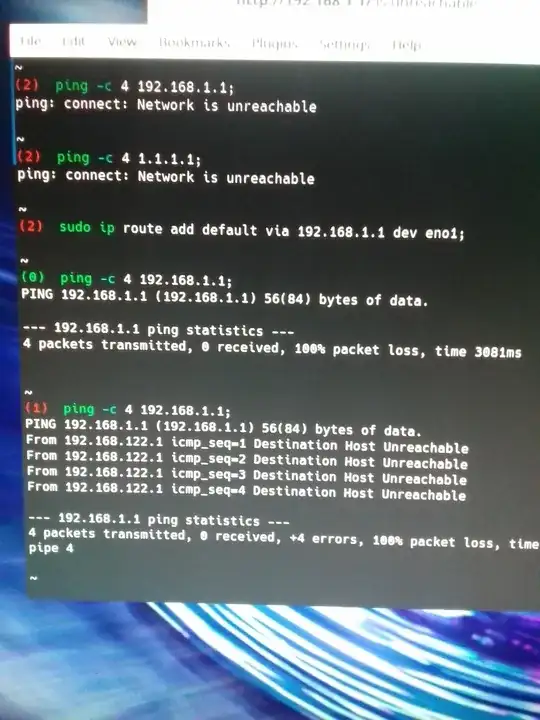

ping gives network unreachable with IPs and temporary failer in name resolution with domains

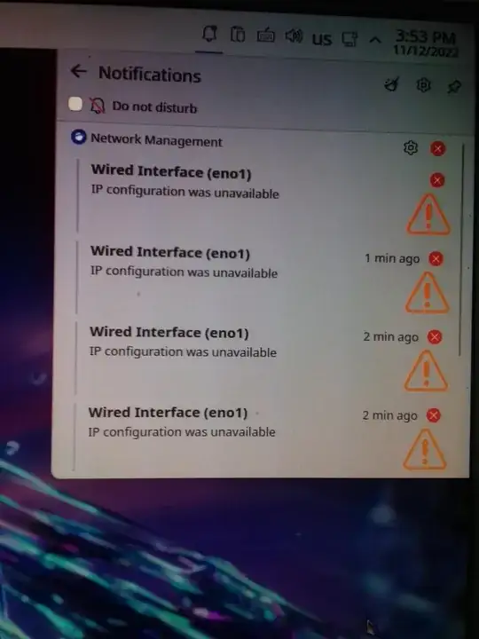

network manager is keeping attaching and deattaching network with IP configuration was unavailable

  • I tried adding default route to my interface and now pinging ip is go throgh network but with 100% packet lose

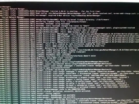

3: add lspci and journalctl output
