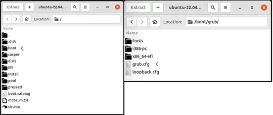

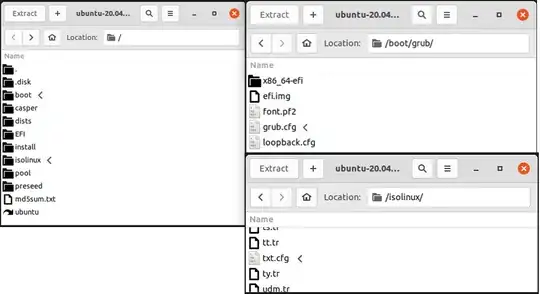

enter image description here File location 20.04 and prior.
  • In Ubuntu 22.04 and later add the word persistent one space after file=/cdrom/preseed/ubuntu.seed in grub.cfg.
enter image description here File location 22.04 and later.
