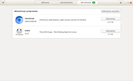

Update: There was an answer to this question (now non-existent) that told me to remove the CUPS snap - it should apparently be not possible if other snap depends on it. However, I was able to remove it without any problem. I checked snap list and it wasn't there. Today I got a notification that it wants to update (see screenshot below), so I did snap list again and it is there.
I checked journalctl -ru snapd as indicated in the (now non-existent) answer and it turns out that after I removed the snap on November 9th, it got somehow installed again on November 12th. The log shows:
Nov 12 22:01:20 jarek-02 snapd[786]: snap has no updates available: "bare", "caprine", "chromium", "core", "core18", "core20", "cups", "gnome-3-28-1804", "gnome-3-34-1804", "gnome-3-38-2004", "gtk-common-themes", "overlay", "snap-store", "snapd"
Nov 12 22:01:20 jarek-02 snapd[786]: storehelpers.go:748: cannot refresh:
Nov 12 16:49:20 jarek-02 snapd[786]: storehelpers.go:748: cannot refresh snap "chromium": snap has no updates available
Nov 12 16:48:58 jarek-02 snapd[786]: autorefresh.go:540: auto-refresh: all snaps are up-to-date
Nov 12 16:48:58 jarek-02 snapd[786]: snapstate.go:1591: cannot refresh snap "chromium": snap "chromium" has "refresh-snap" change in progress
Nov 12 16:48:58 jarek-02 snapd[786]: snap not found: "syzygy"
Nov 12 16:48:58 jarek-02 snapd[786]: snap has no updates available: "bare", "caprine", "core", "core18", "core20", "gnome-3-28-1804", "gnome-3-34-1804", "gnome-3-38-2004", "gtk-common-themes", "overlay", "snap-store", "snapd"
So If I read it correctly, on Nov 12, 16:48, the CUPS snap wasn't there (it is not listed in "snap has no updates available" message and the same set of snaps is listed in previous occurrences of that message), and on the next check, on Nov 12, 22:01, it was already there. Between these two, the Chromium snap was updated. So is it possible that the CUPS snap is automatically installed with Chromium?
