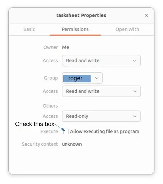

The GUI and Mouse way
Open the app Files (AKA Nautilus) and right click on the file tasksheet inside Files.
Select Properties from the right click context menu. Go to the Permissions tab:
Check the box Allow executing file as program.
You only need to do one or the other, not both. After that, you can use the command:
.tasksheet
See How can I make a script executable? for more.
