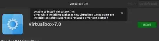

How do I install Virtualbox 7.0.2 on Ubuntu 22.04 using the Ubuntu Software Center?
This is complicated by the fact I installed a Virtualbox 7 beta.
More specifcally, I get the following error when trying in Ubuntu Software Center using virtualbox-7.0_7.0.2-154219_Ubuntu_jammy_amd64.deb:
Unable to install virtualbox-7.0:
Error while installing package: new virtualbox-7.0 package
pre-installation script subprocess returned error exit status 1
