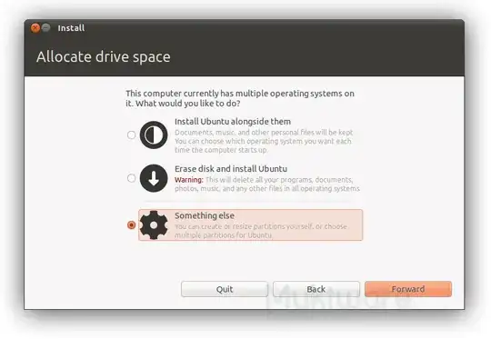

When you install it, simply use the entire Hard drive (Erase disk and install Ubuntu). No need to uninstall Windows.
