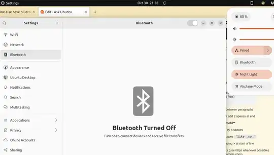

I upgraded from 22.04 to 22.10 a couple days ago, had some initial issues related to GDM, and now bluetooth doesn't seem to turn on - meaning I can't use my keyboard or trackpad unless over usb.
I've tried:
  • rebooting. still happens
  • turning bluetooth on from settings menu and quick settings (see screenshot) - stays stuck at off.
  • running bluetoothctl which just says Agent Registered
  • looking at can't connect any bluetooth device after updating from 22.04 to 22.10 ubuntu but their issue seemed different.
  • searching around in journalctl, can't find anything under searching 'bluetooth', is there something else to look for?
Any ideas?
