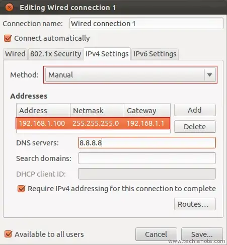

Easiest method of configuring your DNS servers is to use NetworkManager
Under IPv4, fill in your dns server(s)
