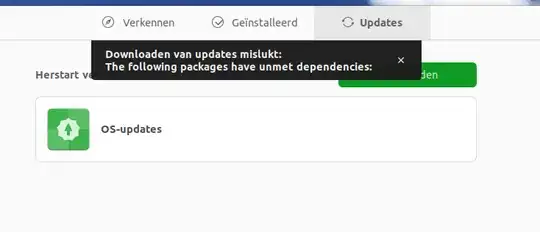

I am on Ubuntu 22.04LTS. On startup I get a message: Pending updates of snap-store store. Close the app to avoid disruptions. So I close and refresh snap as explained in this post: Pending Update of Snap Store. On the command sudo snap refresh I get the response All snap are updated. But the message keeps showing, also when I restart the computer.
Then in Software there are OS-updates. When I click on the download-button I get the message. Download of updates failed: The following packages have unmet dependencies:. The message does not say what dependencies are unmet. It simply stops after the colon.
I don´t know if the two problems are related. I found several posts on the second problem, but none of them solved it for me. I would really like to be able to keep the operating system up to date. What can I do?

johannes
  • 195
it's probably related to the latest bug, that made Ubuntu store "Snap apps only". Actually i believe this thread is relevant to this issue. I have same issue on my freshly installed machine.
In short:
sudo killall snap-store
sudo snap refresh
Refresh will install downloaded fixes and after that everything become "up to date".
