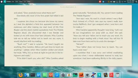

Use Foliate, an epic epub reader. It support text to speech, on the fly translator, word meaning and Wikipedia search.
You can download deb file. Or install ppa on ubuntu 18.04+ via
sudo add-apt-repository ppa:apandada1/foliate
sudo apt update
sudo apt install foliate
Foliate can also be installed with snap by:
snap install foliate
