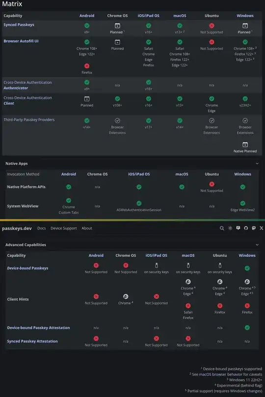

Passkey official device support page has the following table:
The latest KeePassXC from the PPA can store and use passkeys. See the Additional Software section below.

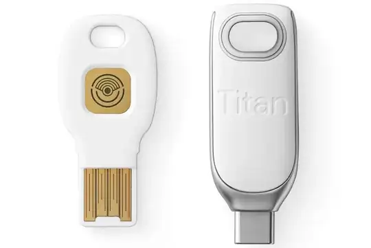

This is another alternative to Yubikeys described in the accepted answer. I use a Google Titan Security Key (USB C one).
Titan Security Keys
This key can store up to 250 passkeys in it. As far as I know, there is no way to copy, move, delete, or otherwise manually manage the passkeys stored in this USB key.

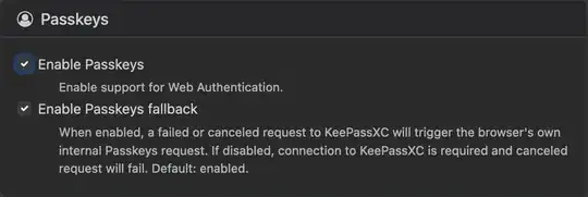

I installed KeePassXC from the PPA and the browser extensions for Chrome and Firefox. In the Settings page of the KeePassXC-Browser Extension, scroll down in the General Tab till you see the Passkeys section. Make sure both
  1. Enable Passkeys
  2. Enable PassKeys Fallback
boxes are checked.

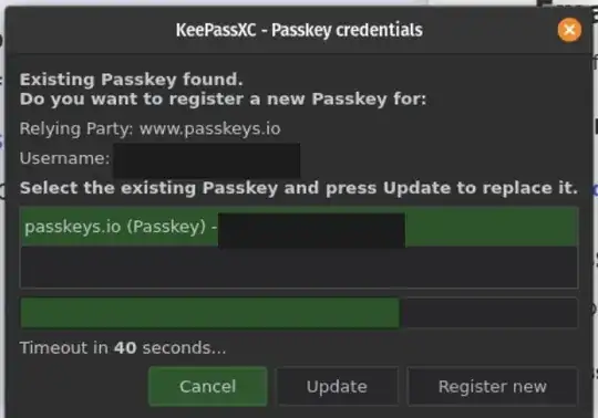

I tried this in Firefox and Chrome. The KeePassXC application (and the database) was open in the background and the browser extension was active. I already created the first passkey and took the screenshots during creation of a second passkey under the same account. When I clicked on the Create a passkey button on the web, the following popup showed up from the KeePassXC browser:

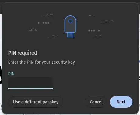

Pressing the Cancel button gave me the "Fall back option" of using the USB-Key by showing the Enter PIN popup window:
By entering the PIN of my USB-key, I could create a new passkey and store it in the Google Titan Security Key.

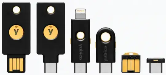

  • Security keys like Yubikey (but only certain versions, my old Yubikey did not work) Photo of Yubikey devices
