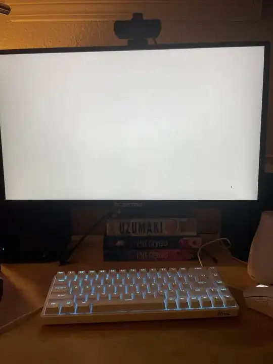

I am having trouble installing ubuntu onto my computer. When I boot my computer, it takes me to a completely white screen(as shown below). I am entirely new to this and would like some guidance in resolving this issue. Thank you in advance for all your help.
Processor: AMD Ryzen 5 5600G with Radeon Graphics
Graphics Card: GTX 1650 Ram: 16 GB Motherboard: ROG STRIX B550-A GAMING

I had the same issue , seems a problem on kernel 5.19 and AMD cpu .
I resolved changing grub configuration, adding nomodeset to grub, like this:
edit grub config using gedit or nano :
sudo gedit /etc/default/grub
change this line:
GRUB_CMDLINE_LINUX_DEFAULT="quiet splash"
to this:
GRUB_CMDLINE_LINUX_DEFAULT="quiet splash nomodeset"
save and update with sudo update-grub2
This prevents Linux loading a specific driver. It's a workaround not a solution but at least you can use yor pc. Anyway kernel 6 should fix it.
