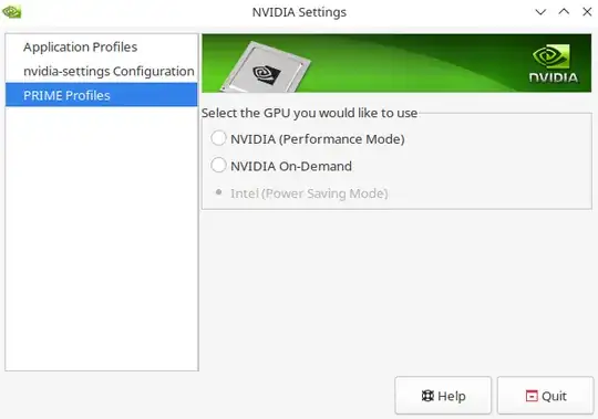

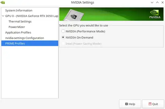

I am running NVIDIA driver 515.65.01 and Kubuntu 22.10. I want to set my computer to only use my integrated GPU, as on-demand mode is still allowing Xorg to run on it. However, the setting to do so is grayed out. How can I fix this, or, failing that, accomplish this through some other method?

Disclaimer: This only works on Ubuntu and Ubuntu flavors
Intel-only mode can be manually enabled via sudo prime-select intel and then performing a system reboot. Intel-only mode remains grayed out but is selected.
I am pretty sure it does work as nvidia-smi returns the following message:
NVIDIA-SMI has failed because it couldn't communicate with the NVIDIA driver. Make sure that the latest NVIDIA driver is installed and running.
