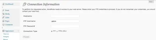

I have installed wordpress on my ubuntu 10.10 desktop edition and I am trying to install plugin from the browser (I know I can drop it to the wp-content/plugin but I want to do it via the web browser using FTP) I get this screen when I am trying to set auto update or install a plugin from web browser.
alt text
I provide the hostname 127.0.0.1 and Username and password the ones that I use to login to wordpress. I get the error
Username/password Incorrect and cannot connect to 127.0.0.1:20
