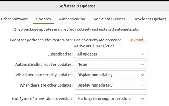

I am still getting notices that new software is available. Note that it is not installing the software, it is just notifying me every morning that I have new software to install. So it is clearly still checking repositories for new packages. See:

  1. It is clearly still checking repositories (and I don't know what else). I am trying to limit bandwidth because I am on a metered internet service (rural). How do I make it stop? (I thought "Automatically check for Updates --> Never" would mean don't check the repository for updates).
  2. Since I am not installing updates regularly, there are always updates to install. How do I make it stop prompting me to install updates?
