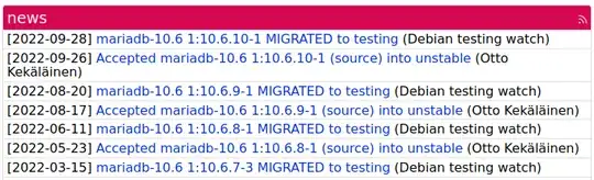

Let's see what the Debian Package Tracker (tracker.debian.org), says about mariadb-server (https://tracker.debian.org/pkg/mariadb-10.6) in October 2022.
You can see that Debian has packaged newer releases. But check those dates against the Ubuntu deadline for inclusion into 22.10:
10.6.9 was migrated into Ubuntu 22.10 (check apt on a 22.10 system: It's there). It's now eligible for backporting to earlier releases (like 22.04).
10.6.10 was a month too late. It --or some other newer release-- will be included in the next release of Ubuntu: 23.04, to be released in April 2023. After release, it will become eligible for backporting.
