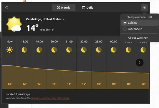

Ubuntu Unity does not have either GNOME Calendar or GNOME Weather installed by default. I manually installed GNOME Calendar. While it did show the temperature, there was no way to configure the units.
The solution is to install GNOME Weather, and change the units in its configuration. GNOME Calendar will then automatically pick it up.
sudo apt install gnome-weather
