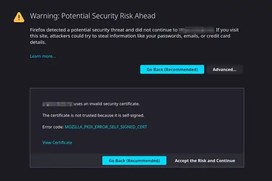

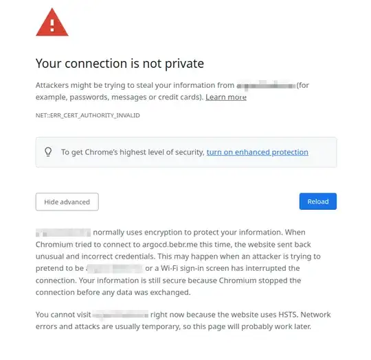

When I visit the host address, I get this:

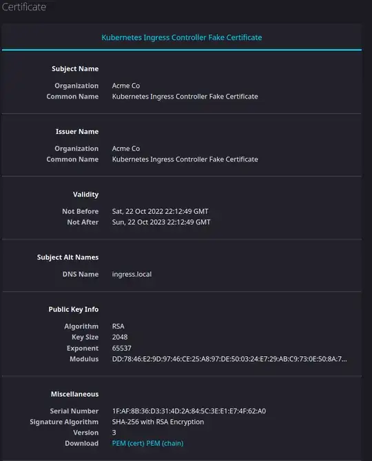

From firefox, here's the certificate being issued.

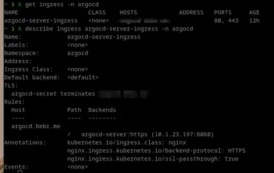

Here's what the ingress description looks like: enter image description here

The Error message did indicate an invalid Certificate which was not accepted by the browser. The ingess configuration requested a certificate and ssl-passthrough which does not fit together. The line kubernetes.io/tls-acme: "true" had to be removed from Ingress and a minor change of the service name.
The TLS connection to ArgoCD is terminated at the ArgoCD Server and not at the ingress GW. ArgoCD uses the Certificate (and Priv Key) stored in the argocd-secret. ingess should look like

a kubectl get Ingress -n argocdresults in
NAME                    CLASS    HOSTS                 ADDRESS         PORTS     AGE
argocd-server-ingress   <none>   argocd.k3sxx.xx   192.168.xx.xx   80, 443   15m
and details can be seen with kubectl get Ingress -n argocd -o yaml
