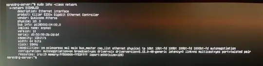

Output of sudo lshw -class network :
output of lshw

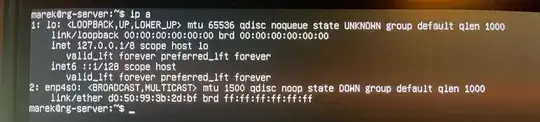

Output of ip a :
output of ip a
The network interface shows disabled and no matter how I try to turn it back on, it does not stay on or work. I still can't use apt update as an example.

I figured it out. I needed to get my network interface to be managed to activate it. I also found out that my sources.list had https in all the links instead of http.
I found the info from these two links and probably a few more, couldn't find some of them.
