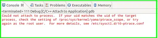

  • I logged in as root but strace gives me this:
    root@kyznecov-System:/home/kyznecov# ps -e | grep 111
     3807 pts/2    00:00:00 111
     3810 pts/2    00:00:00 111
    root@kyznecov-System:/home/kyznecov# strace -p 3810
    attach: ptrace(PTRACE_ATTACH, ...): Operation not permitted
    Could not attach to process.  If your uid matches the uid of the target
    process, check the setting of /proc/sys/kernel/yama/ptrace_scope, or try
    again as the root user.  For more details, see /etc/sysctl.d/10-ptrace.conf
    root@kyznecov-System:/home/kyznecov# cat /proc/sys/kernel/yama/ptrace_scope
  • I then tried to use gdb to debug a multiprocess program in Eclipse CDT with forking, and it gave me the same result/error:
Any ideas?

One reason to get the error:
is because the process has already been attached to with gdb, strace or similar. To check if this is the case, run:
grep TracerPid /proc/$THE_PID/status
If it is nonzero, that is the pid of an existing program that is already running a trace on that process.

As izx has commented, this should only be able to happen due to a kernel bug. So anyone who can currently produce this problem--including and especially the original poster of this question--would be well-advised to report it as a bug by reading that page thoroughly and carefully, and then running ubuntu-bug linux on the affected machine. This should be reported against linux in Ubuntu, and not against a mainline (upstream) kernel, unless you can produce it on a mainline kernel (you'd have to have yama loaded).
The expected behavior in every version of Ubuntu starting with Ubuntu 10.10 is that process A cannot trace a running process B unless B is a direct child of A (or A runs as root). This is a security enhancement, which makes it so that a process that has been compromised by an attacker cannot use debugging facilities provided by the kernel to discover information from other processes. This is explained in the ptrace scope section of the Security Features community wiki page.
This restrictive behavior is the default but can be changed to allow a process A to trace any running process B that is run with the same user ID as process A's own. That is, you can configure your system to allow any of your processes to debug each other. This simplifies attaching debuggers to already-running processes.
The setting for this is exposed in by the /proc/sys/kernel/yama/ptrace_scope sysctl. 1 denotes the more restrictive behavior and 0 the less restrictive behavior. The setting can be read with:
The less restrictive (non-default) behavior can be set with:
echo 0 | sudo tee /proc/sys/kernel/yama/ptrace_scope
And the more restrictive (default) behavior can be set (or set back) with:
echo 1 | sudo tee /proc/sys/kernel/yama/ptrace_scope
Not only was the original poster of this question unable to attach an strace instance to a currently running process with ptrace-scope set to 0, but the original poster was then still unable to do so when running strace as root. It's hard to see how this could be anything but a bug--I strongly recommend reporting it as one.
