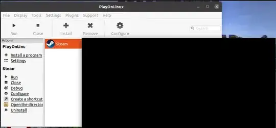

When I try to run Steam from PlayOnLinux (Wine) it launches to a black screen.
![enter image description here

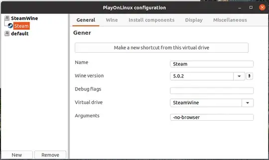

I have no arguments being used in configuration:

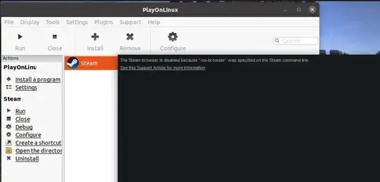

and when I add -no-browser per this previous question.
I still get a black screen, but also this error:
How can I launch steam with Wine and get past the black screen?
