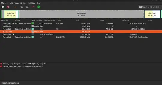

I have several operating systems right now. Only two of them work. My Ubuntu is a dual boot with Windows 10.
I want to erase everything else and only have Ubuntu. Is it possible? If so, how?
screenshot of partitions with large unallocated area
Zanna
  • 72,312
Based on the screenshot you added to the question,there is a large unallocated portion of the storage device adjacent to your Ubuntu partition.
Based on the comment that the goal is to recover space on the storage device, it would be relatively easy to
  1. Make a backup of your data
  2. Boot to a live USB
  3. Use gparted to expand the Ubuntu partition left into the unused space
However this does not address removing the other OS's you mention. Please provide details on what they are and where you see traces of their existence.
If Ubuntu is your first partition, it should be possible to free all other partitions and extend the first one to occupy the 'liberated' space. gparted (probably as administrator) should help you visualizing how your disk is organized.
If Ubuntu is not your first partitiion, it might still be possible, but you'll have remove the other partitions, and move ubuntu down, then extend.
Be careful... And read about what gparted does.
I you have little experience, and have little or no data, do what @david commented above!
