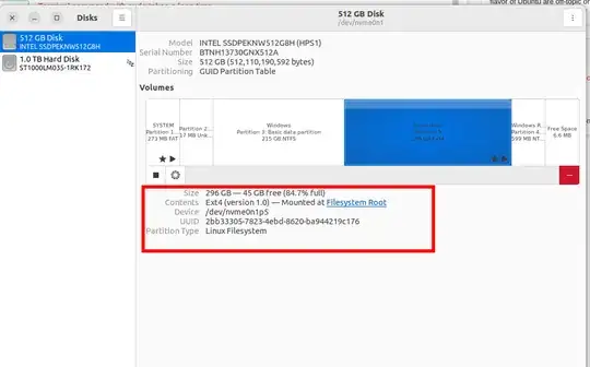

The sudo command execution was working fine until a few days ago, and it started working slow. When I run a sudo command in the terminal, it does not work faster. It takes a break of a few seconds to ask for the password.
If the password is already entered in the terminal, executing the command will take a bit of a delay. How do I make it faster? I am not getting a reason why it slows down. My disk space where ubuntu is installed is 45GB free.
