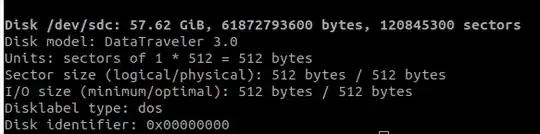

Output of fdisk -l:
fdisk -l

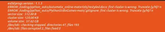

Output of fsck.exfat -p:
fsck exfat -p

fsck.exfat -v output: fsck.exfat
