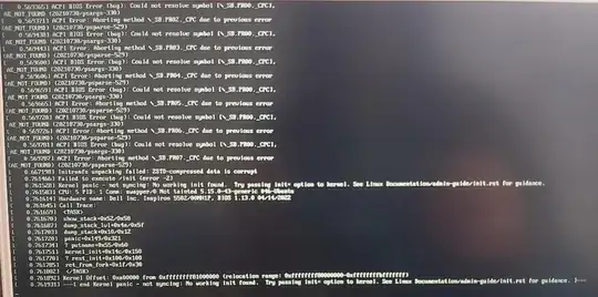

The laptop (dell inspiron 5502) runs 20.04 and was fine before. However I think /boot ran out of space (a combination of ubuntu's installer defaults being too small, and ubuntu not removing old kernels) which probably caused the initial failure.
screenshot
What's weird is that I get the same (well, v similar) errors trying to run Ubuntu 22.04 off a memory stick: get the Initramfs unpacking failed error.

What fixed it seems to have been to switch to COMPRESS=xz in /etc/initramfs-tools/initramfs.conf
Changing that then recreating an initramfs meant I could boot that kernel.
The non compress and the lz4 option seem to have bugs in decompression; even a new Ubuntu (22.04) live USB would cause kernel panic. I don't understand this, it's not to do with space, but this is what I did to get around the problem. This happened on a newly installed kernel and a reinstalled one.
(The issue about cryptsetup warning that target 'crypt' was not in /etc/crypttab is a red herring - at the time I was running that code I had had to boot from an initrd> prompt, specifying my own cryptsetup command, then using lvm to identify the volume. I had used crypt as the device name, so cryptsetup was warning me that I currently had a partition mounted as crypt, but this was not in my crypttab. Since I am referencing things with UUIDs, the mapper name doesn't actually matter.)
