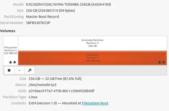

More details about my disk partitions are below: enter image description here enter image description here
fdisk is giving this output:
~$ sudo fdisk -l /dev/nvme0n1
Disk /dev/nvme0n1: 238,49 GiB, 256060514304 bytes, 500118192 sectors
Disk model: KXG50ZNV256G NVMe TOSHIBA 256GB
Units: sectors of 1 * 512 = 512 bytes
Sector size (logical/physical): 512 bytes / 512 bytes
I/O size (minimum/optimal): 512 bytes / 512 bytes
Disklabel type: dos
Disk identifier: 0x5b307d3a
Device Boot Start End Sectors Size Id Type /dev/nvme0n1p1 * 2048 1050623 1048576 512M ef EFI (FAT-12/16/32) /dev/nvme0n1p2 1052670 500117503 499064834 238G 5 Extended /dev/nvme0n1p5 1052672 500117503 499064832 238G 83 Linux
Not sure exactly what this means or how it can be fixed. Excuse me in advance if this is a naive question. Any help would be appreciated.
