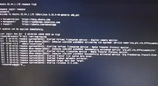

If it is any helpful running tail /var/log/syslog shows this.
I'm sorry if my question was unclear. I meant that my Ubuntu OS shows "Something went wrong" not the racket app. Photo here

Try using ALT + CTRL + F2 you will enter into command line.
Then just enter your administrator username and password. Then just use simple commands like - "sudo apt update" - "sudo apt upgrade -y" - "sudo apt autoremove" (Without colons) Then just restart your computer by either method by manually and or by command line itself "reboot" command.
