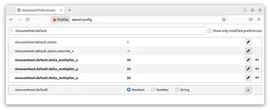

I've given up on getting this to work.
Note, although I am on Ubuntu 22.10, the same issue is present on older Ubuntu versions too.
I did find a workaround by doing the scrolling per app if the app has a setting for it.
For instance, Firefox:
Go to URL about:config
Accept the risk and continue.
Then search for mousewheel.default and set the multiplier values to something lower.
