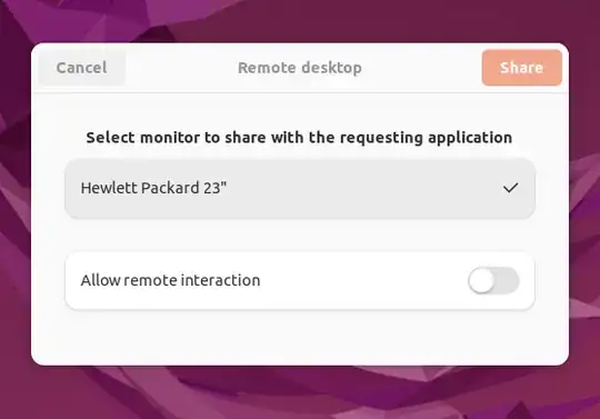

I am using Teamviewer to gain remote control to my Ubuntu wipe server, but I am getting this message that I need to accept the connection otherwise it will not get any connection. I want to make sure that I always can make a connection without needing to accept the connection.
Screenshot of the message:

This is probably caused by having Wayland enabled.
Method to switch from Wayland to X (to make Firefox work)
Edit the configuration file,
sudo nano /etc/gdm3/custom.conf
to uncomment [remove # from] the line containing
WaylandEnable=false
save the file (ctrl + x and after that y ('yes') or another key for non-English and finally Enter) and reboot.
