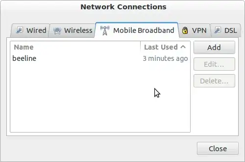

Graphical Way
Open Network-Connections, go to tab 'Mobile Broadband'
Screenshot, Network-Connections

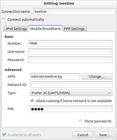

Click 'Edit' and go again to the tab 'Mobile Broadband'
Screenshot, Mobile Broadband
Enter your PIN here, then it shouldn't ask for it again.
