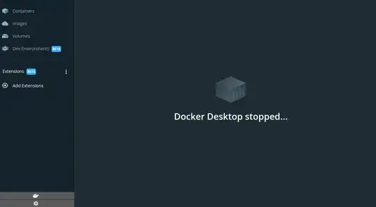

If VirtualBox is playing the Windows 11 machine, when I open docker-desktop it never starts. I just get this message and it never passes this stage.

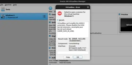

On the other hand, if docker-desktop was turned on before starting the virtual machine I get this error.

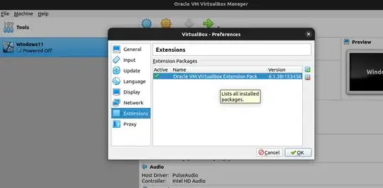

If it helps, I also have the VirtualBox Extension Pack installed:
