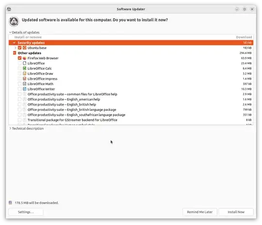

However, this question is about the Software Updater. Ever since the 22.04 upgrade it sometimes shows me software that is available to Upgrade, but it won't let me select any of it. Here is a recent example:
software updater before update is applied
I had to dig to find out what the boxes with exclamation marks mean - upgrade available, vs. update available - but I cannot select them. They are grayed out.
Which packages it lists varies with a given run.
I could go run apt to deal with these, but I don't know if it is safe to do so. Perhaps they need some other piece of software to be updated (or upgraded) before I upgrade them? And if it is safe to upgrade them, why not just have the software updater do it automatically?
I stress, this has never happened before in any of my previous LTS installations, and I have no clue why the behavior changed. I know it did change after the 22.04 upgrade. I also know that I have done nothing to avoid updates with the exception of avoiding the Firefox SNAP since that was utterly unreliable.

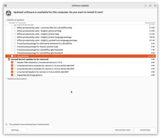

A second question that might be related. The update pictured above installed a new kernel. Fair enough, but the updater has stopped telling me that a reboot is needed after a kernel installation. The above update finished and gave me this:
image of software updater after update is complete
No indication a reboot is required, all the same packages that it told me need upgrades are still listed, and in addition it now includes the old kernel packages to remove.
But I haven't even rebooted. In 20.04 when I installed a new kernel it came back with an empty package list and told me a reboot was required. Only on subsequent runs of the software updater would it list the kernel packages that could be removed.

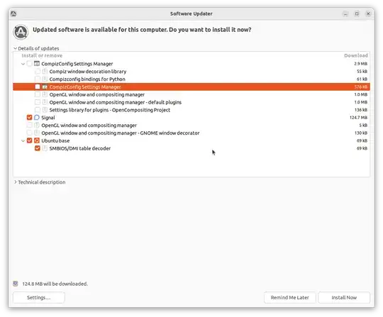

I've mentioned that packages other than LibreOffice wind up in this same state: listed as available for upgrade but unselectable in the software updater UI. Here is a screen capture showing some others that were in that state on Sept 8. I didn't originally include this image because I thought the ones above would be adequate. But since LibreOffice can do phased updates, perhaps that hid the depth of the issue. So...
software updater showing other packages that I cannot select
