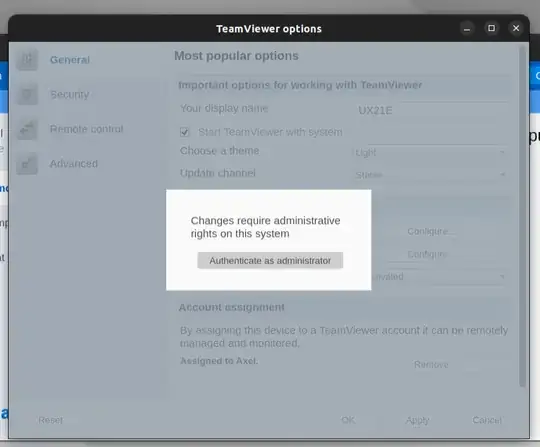

Some app (teamviwer) needs root password to change configuration. I have problem, because when I click on button to "ask of root permission" nothing show. enter image description here
It's the same issue one wayland and xorg. I have second laptop this the same ubuntu, the same teamviwer and there popup works. I don't know what should check/reconfigure/reinstall.
I was found a reason with a workaround, but can't find a permanent solution. Anny suggestion please?!
Problem start after add by me file /etc/polkit-1/localauthority.conf.d/90-silence-steam.conf whose is a response if STEAM admin popup issue from topic https://github.com/ValveSoftware/steam-for-linux/issues/7856#issuecomment-883386818

When I rm/rm this file from localization /etc/polkit-1/localauthority.conf.d/ popups start working
Any idea how fix this permanently and safe this file to fix steam popup?
