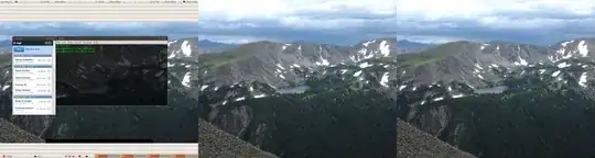

issue seems related to OpenGL and the multiple video cards -- I can boot into Unity without issue though my Glx-Dock shows up with the black background as barely shows in the screenshot below indicating the OpenGL is not initiated

Screenshot with Buggy Fallback Mode
