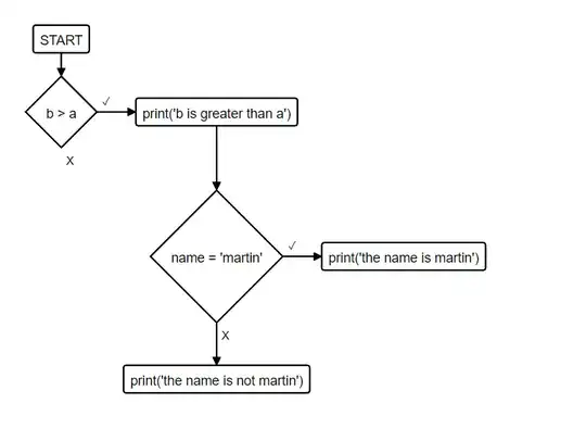

I could run a command in terminal like diagram generate myScript.py and it would output something like this :
example of diagram
Is there any package that could help me with that ?

PyFlowchart is a package to:
  • write flowcharts in the Python language
  • translate Python source codes into flowcharts
PyFlowchart produces flowcharts in the flowchart.js flowchart DSL, a widely used flow chart textual representation. It's easy to convert these flowcharts text into an image via flowchart.js.org, francoislaberge/diagrams or some markdown editors.
To install PyFlowchart in all currently supported versions of Ubuntu open the terminal and type:
sudo apt install python3-pip
pip3 install pyflowchart
To make a flowchart for your example.py Python code run:
python3 -m pyflowchart example.py
PyFlowchart will output the generated flowchart.js DSL. Go to http://flowchart.js.org or use a markdown editor like Typora (sudo snap install typora) to turn the output code into a rendered logical diagram.
Source: revised from pyflowchart - PyPI
