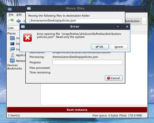

I'm running a copy of Lubuntu 22.04 on an old Dell Inspiron 531s.
I'm trying to get a file from the Desktop into the location shown in the image below, even though pcmanfm-qt has been opened as a "root instance." This instance was opened using the instructions in the page linked to below...
https://www.mycomputertips.co.uk/113
Moving a file from the desktop to a file manager that has been opened as root has never been an issue before with previous distributions of Lubuntu. Can someone show me how to get this file moved successfully? I would appreciate it! Please ask if you need additional information. Thank you for your time! :-)
error message
I was able to solve this problem using the instructions in the page linked to below, praise and thanks to God! :-)
https://fostips.com/ubuntu-21-10-two-firefox-remove-snap/
After purging the Firefox snap package and installing the .deb version of Firefox, I then was able to bring up the file manager as a root instance again and move the file in question to the desired folder. :-)
