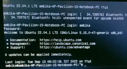

I installed Ubuntu 22.04.1 and it was working fine until after couple of restarts. Now, it no longer boots to a desktop environment. I get this black screen with login:
Ubuntu login (no DE)
After entering the password it enters a directory and not the desktop.
I am new to Ubuntu.

My Ubuntu laptop stopped loading the desktop environment after trying to "fix" the sound by running the commands at https://askubuntu.com/a/1441491/282606 - I should have read the comments first though.
This post saved me as the comment by Archisman Panigrahi fixed it, but it deserves its own answer:
sudo apt install --reinstall ubuntu-desktop
Thanks Archisman!
