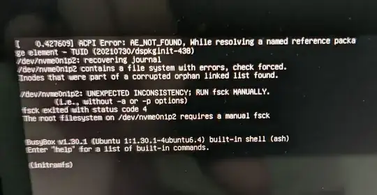

I've recently had an SSD disk problem after booting Ubuntu 20.04 Linux: a disk problem
The file system had errors, but fortunately, after running fsck the machine is working again. The fsck fixed many errors, probably hundreds.
The machine is dual boot, each OS having a separate 1TB SSD drive:
  • Microsoft Windows 10
  • Linux Ubuntu 20.04
THE PROBLEM HAPPENED AFTER WINDOWS WAS BRIEFLY USED FOR A FEW MINUTES - after the machine was booted again into Linux, it showed the above errors.
What should I do to prevent this in the future:
  • Will the OS upgrade be of any help?
  • IS the new SSD drive the only way?
Danijel
  • 485
The error "ENEXPECTED INCONSISTENCY; RUN fsck MANUALLY." happens whenever the system detects that the file system is damaged, to the extent that an automatic file check is not anymore possible. It can happen if the system crashes, or if the computer was improperly shutdown, e.g., because of a power outage. That way, the system cannot properly close the open files and update the file system, leaving it in an inconsistent state. If, despite properly shutting down, the problem reappears regularly, then expect a failing drive that may need replacement.
Not at all. A supported operating system will keep the drive in a healthy condition if the computer does not shut down improperly.
Is the new SSD drive the only way?
First you need to find the cause of the problem. If the issue reoccurs even if the system was correctly shut down by choosing "Power Off", then start suspecting the drive.
