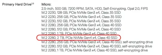

The goal is to determine if a Gen-4 NVMe is supported (Gen-4 bandwidth) in a Dell 3090 micro i3 10105T (Comet Lake).
  • NVMe slot is vacant
  • SATA Drive outfitted with OSX and Ubuntu
How to determine from command line if NVMe slot is gen 3 or gen 4? It is not clear to me that lsblk will reveal the NVMe specs.
The link does indicate a single instance of NVME-4:
It would preferable to confirm NVME-4 compatibility from the command line: before buying the drive. Reddit seems to indicate 10th gen CPUs do not support NVME-4?
