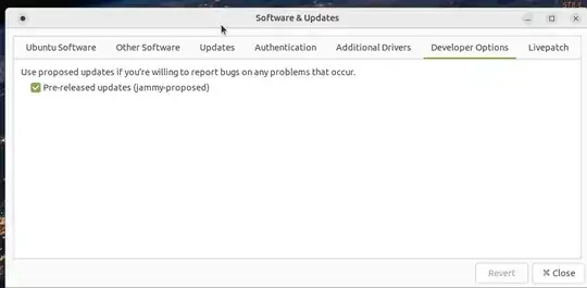

  • Step 1 - Enable the proposed repo as explained in the wiki

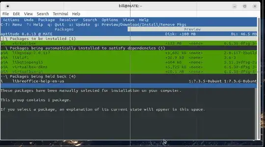

  • Step 3: Manually install only the packages one wants from the proposed repo
As the wiki says, fire up aptitude thusly:
sudo aptitude -t jammy-proposed
Now search in aptitude for virtualbox. When you find it, highlight it and press + to mark it for installation. Aptitude will find and mark its dependencies as well. It will look like this.
Now press g to install the packages. When it's finished, quit aptitude.

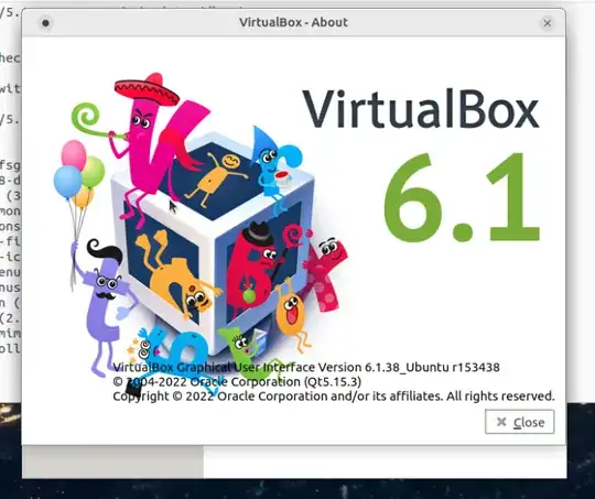

and run it!
