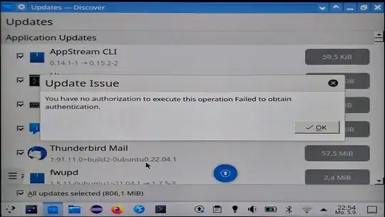

On my laptop the screen resolution stays at VGA's 640x480 after upgrading from 21.04 to 22.04. I tried to install further updates in Discover (hoping that this would resolve the issue) but when I click Install there the pwd dialog appears for fractions of a second and then there's:
Discover - Update_Issue

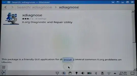

I found Screen resolution stuck at 640x480 after upgrade but if I try to use Xdiagnose I get this in Discover:
Discover - Xdiagnose
and nothing happens no matter how often I click Install.
