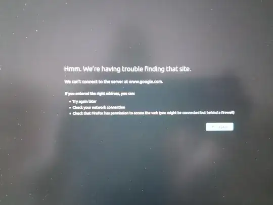

...but, my browsers can't navigate on internet :/ I don't understand why... By example, when I open firefox, I get this page :

As expected, its an ubuntu issue and this answer help me to fix it :)
https://askubuntu.com/a/1273633/621125
edit :
From a quick look, the issue is a bad configuration of the current /etc/resolv.conf file. Replace this file by /run/systemd/resolve/resolv.conf file resolve my issue, here the commands I used :
sudo rm -f /etc/resolv.conf
sudo ln -s /run/systemd/resolve/resolv.conf /etc/resolv.conf
Reboot may be necessary
