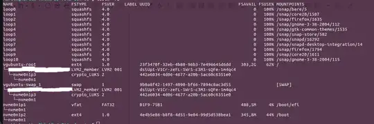

Update: Here comes a screenshot from lsblk as I read in other posts that this is needed.
But I do not know how to read this.
2nd update: According to muru's wish I also post the output of lsblk as code:
    lsblk -fs
NAME                       FSTYPE      FSVER    LABEL UUID                                   FSAVAIL FSUSE% MOUNTPOINTS
loop0                      squashfs    4.0                                                         0   100% /snap/bare/5
loop1                      squashfs    4.0                                                         0   100% /snap/core20/1587
loop2                      squashfs    4.0                                                         0   100% /snap/firefox/1635
loop3                      squashfs    4.0                                                         0   100% /snap/gnome-3-38-2004/112
loop4                      squashfs    4.0                                                         0   100% /snap/gtk-common-themes/1535
loop5                      squashfs    4.0                                                         0   100% /snap/snap-store/582
loop6                      squashfs    4.0                                                         0   100% /snap/snapd/16292
loop7                      squashfs    4.0                                                         0   100% /snap/snapd-desktop-integration/14
loop8                      squashfs    4.0                                                         0   100% /snap/firefox/1794
loop9                      squashfs    4.0                                                         0   100% /snap/core20/1611
loop10                     squashfs    4.0                                                         0   100% /snap/gnome-3-38-2004/115
vgubuntu-root              ext4        1.0            23f3470f-32eb-4b80-96b3-7e496645d6dd    303,2G    62% /
└─[somethingsecret] LVM2_member LVM2 001       dsiUpt-V1Cr-zeFL-1Wr5-c3M3-sQFe-1m4qc4
  └─nvme0n1p3              crypto_LUKS 2              442a6034-4d06-4677-a20b-5ac60c6351e0
    └─nvme0n1
vgubuntu-swap_1            swap        1              9b0a8f42-1497-4090-bf66-7894c8ac3d55                  [SWAP]
    └─nvme0n1
nvme0n1p1                  vfat        FAT32          B1F9-75B1                               488,5M     4% /boot/efi
└─nvme0n1
nvme0n1p2                  ext4        1.0            4e4b5e86-b8f8-4d51-9e04-99d5d538bea1    345,8M    44% /boot
└─nvme0n1
